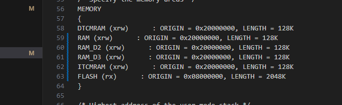

2026-03-03 9:26 PM
Hello @Mahmoud Ben Romdhane
After I enable the switch.
The ld file regenerate as below.
