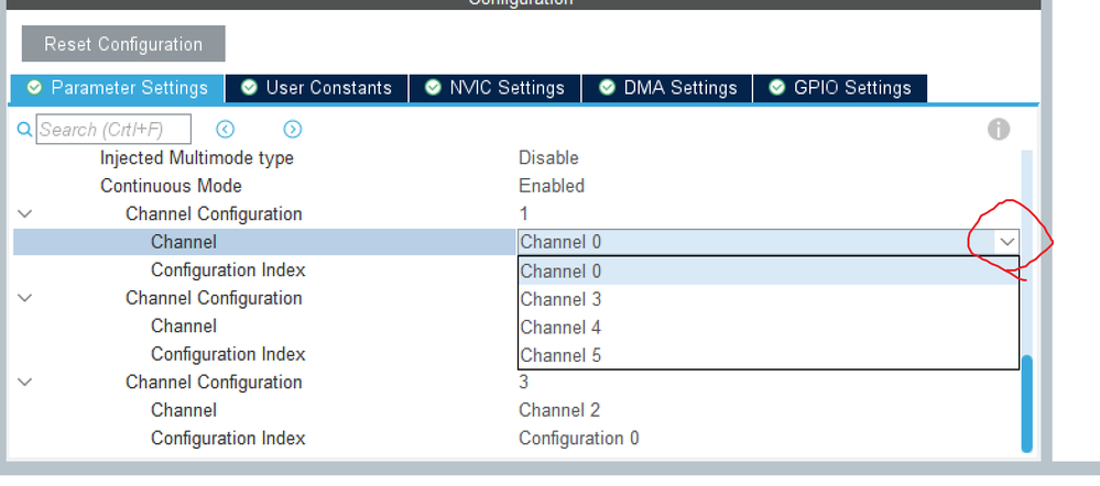

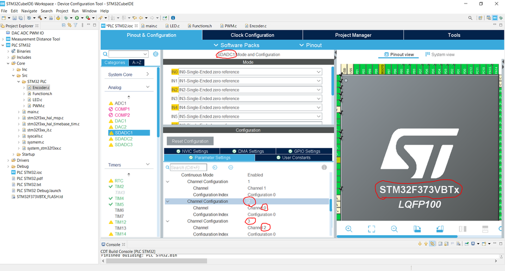

I just want to tell you ST-developers that I have found something that don't looks correct.
Wrong indexing in SDADC. Have a look. STM32CubeIDE 1.6.1

Temporarily reduce the "number of channels to be converted" by 1, change the order to what you want, then change it back to add the last channel.

You've circled a bunch of numbers, but what is wrong about it? What are you expecting instead?

I'm expecting 0,1,2,3,4,5,6,7,8. Not Randomly indexed.
2021-06-13 12:57 PM
The "channel configuration" is the order in which they're converted and is in order (1, 2, 3).
You can change the "channel" to whatever order you want.
2021-06-13 12:58 PM
Sorry. But I can't do that in my STM32CubeIDE 1.6.0.
2021-06-13 1:06 PM
2021-06-13 1:11 PM
Thank you. Now it's working. It seems that CubeMX randomly place the channels at the beginning.
