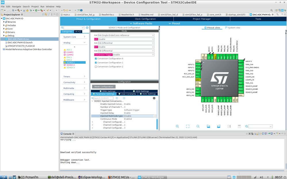

Screenshot of the bug:

2020-12-22 5:52 AM
As you can see in the picture above, I cannot select "Mulimode" because it's disabled. It should not be disabled. It should be an option to select SDADC3 from SDADC1. Therefore, I had to add this manually. Also "Mulimode" is spelled wrong.
But the SDADC works perfectly! I think there is a lack of examples how to use SDADC in STM32.
