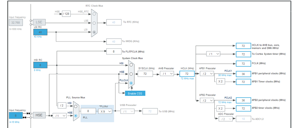

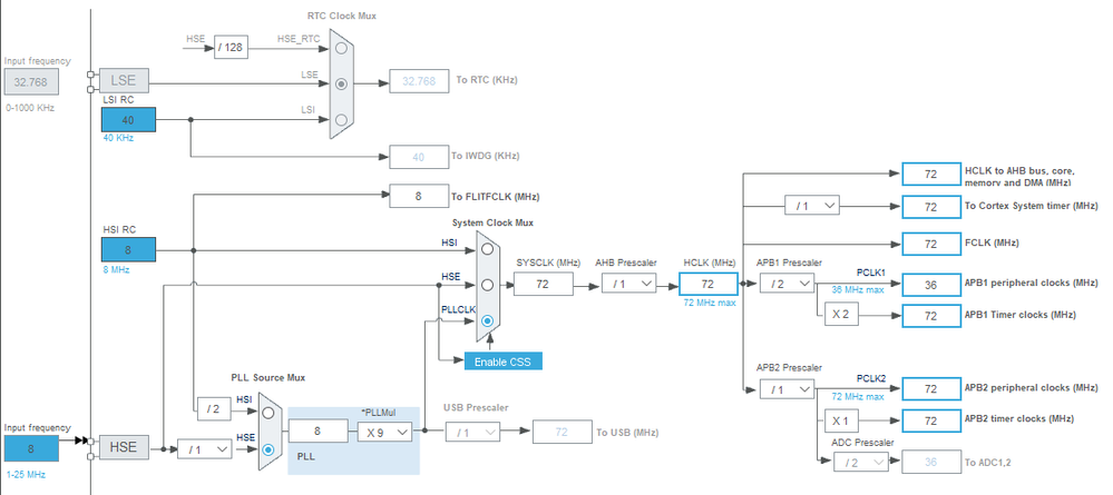

The attachment show the clock configuration:0693W000000TwCNQA0.png

UART2 works correctly only if PCLK1 = 8 MHz with HSI source at 8 MHz. I want UART2 works correctly with the same of clock configuration on the picture.

Where could be the problem? The clock configuration is consistent with the picture ( CubeMX).
