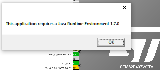

I just installed the latest Atollic package, and the latest STM32cubeMX 4.27.0 plug-in.
Created a cube project, edited the configuration, generated code.
After code generation I clicked Open Project, but it failed:
The newly generated project doesn't show up in the workspace where it was created.
If I add the project manually to the workspace, it does not build.
How can I get past this?
Thanks!
PS: Java(s) installed on this workstation:
c:>java -version
java version "11" 2018-09-25
Java(TM) SE Runtime Environment 18.9 (build 11+28)
Java HotSpot(TM) 64-Bit Server VM 18.9 (build 11+28, mixed mode)
c:>"C:\Program Files (x86)\Atollic\TrueSTUDIO for STM32 9.1.0\ide\jre\bin\java" -version
java version "1.8.0_181"
Java(TM) SE Runtime Environment (build 1.8.0_181-b13)
Java HotSpot(TM) Client VM (build 25.181-b13, mixed mode)

Hi @Dave Nadler ,
Let me share my personal experience and solution:
I have Eclipse (Photon + AC6 plugins) and Atollic TrueStudio installed on my Windows 7 PC.
I generated a STM32CubeMX project for TrueSTUDIO "Toolchain / IDE"
- With STM32CubeMX, open -> Eclipse -> Compilation: can not be launched
This seems to conflict with with eclipse installation and default program set for this type of project.
- With TrueSTUDIO® (9.0.1) -> import -> project build -> OK
I checked .cproject and .project generated by STM32CubeMX and they seem well formed.
- With TrueSTUDIO® (9.1.0) -> the same as 9.0.1
The solution that worked for me was to go into the folder were the .cproject was and thanks to
Properties contextual popup, I changed the "Open with" updated with TrueSTUDIO.exe
I regenerated the project and open from STM32CubeMX launches the correct IDE now.
Hoping it gives ideas where to go.
Regards.
Cyril

2019-01-14 5:36 PM
@Cyril FENARD Thanks Cyril, that works here as well.
