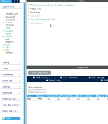

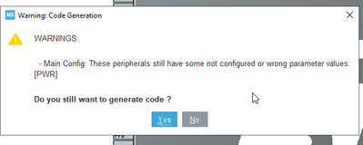

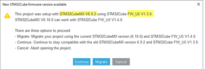

After I migrated my .ioc file from CubeMX 6.9.2 to CubeMX 6.10.0 I get everytime the warning below. I did only the migration. There is now warning available in the "PWR" tab.

Actually, after checking internally, this is a known issue that have been already reported to dev team and tracked with the internal ticket [173382] and this will be fixed asap.
