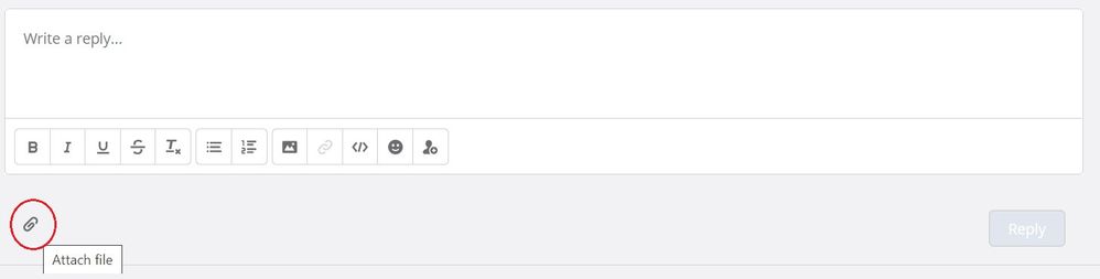

2021-03-08 9:57 AM
Hi @AFerr.1 ,
Thanks for your reply, but you may not correctly attach the files. Please make sure you're using the right tool:
