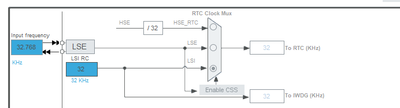

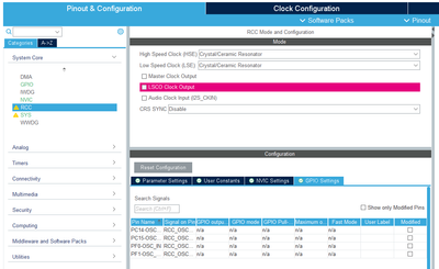

I am using STM32CubeMX to config a project. I used an external 32.768khz crystal. I want to set the RTC clock to the external crystal.
below is my setting.
I think i have enabled HSE and LSE.
the clock to RTC is fixed to LSI RC, but I want to use LSE, not LSI, how can I setting?

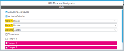

2024-07-22 3:24 AM
I have attached the solve method on the reply.
as below
if you check the activate clock source, then you can choose to LSE.

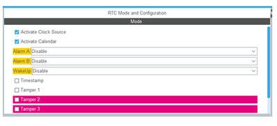

2024-07-22 3:24 AM
as below
Best Regards,

2024-07-22 3:29 AM - edited 2024-07-22 3:29 AM
@dqsh06 wrote:I have attached the solve method on the reply.
But you didn't explain how that differed from what you had before, when it wasn't working; ie, what you actually had to change to go from "not working" to "working".
@dqsh06 wrote:if you check the activate clock source, then you can choose to LSE.
Right - so that was the key to get it working?
Please mark that as the solution:
