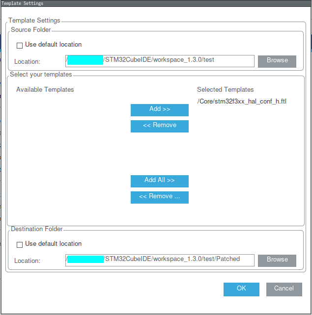

You create a [original file to replace]_[extension].ftl with the following content
Include original template
Base path is project root.
[#assign origFile]
[#include "workspace path to original file"]
[/#assign]
Add USER CODE sections
[#assign userCodeBeginTag = "text in original file, before which to start user code wrapper"]
[#assign userCodeEndTag = "text in original file, after which to end user code wrapper"]
[#assign outFile = origFile?replace(userCodeBeginTag, "/* USER CODE BEGIN 0 */" + "\n" + userCodeBeginTag )]
[#assign outFile = outFile?replace(userCodeEndTag, userCodeEndTag + "\n" + "/* USER CODE END 0 */")]
Output section
${outFile}In my case, it was
[#assign origFile]
[#include "Core/Inc/stm32f3xx_hal_conf.h"]
[/#assign]
[#assign userCodeBeginTag = "#define USE_HAL_ADC_REGISTER_CALLBACKS 0U /* ADC register callback disabled */"]
[#assign userCodeEndTag = "#define USE_HAL_PCD_REGISTER_CALLBACKS 0U /* PCD register callback disabled */"]
${outFile}(full file attached to post)

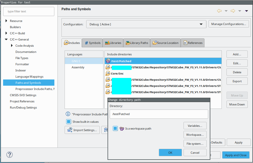

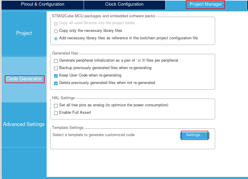

You add this as a user template (do note that all user template files are generated to the same destination folder)
And since the original file is still generated, you need to manage the conflict somehow
