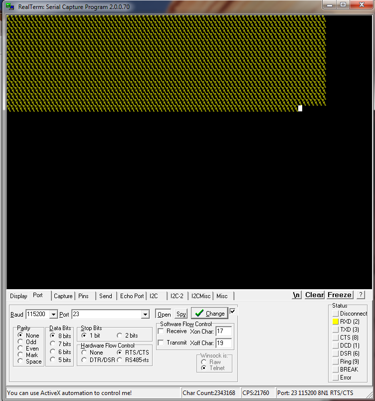

Thanks for taking the time to respond. I get the same results using that as I did with my original code. It prints "null". I don't currently have a potentiometer connected the the ADC pins, I'm just trying to get the code working before I try this on a different board with the same processor that will have states on the pin. STM definitely makes you work for it, you're exactly right about the Arduino world, that's the place I'm used to but I have to get this working on this chip :)

the code is right, you must have something incorrect done with initialization in cube mx or there is some problem with terminal in your computer. I assume you use USB to connect to your PC.
You enable asynchronous in cube mx, disable hardware flow control. Do the DMA data lenght byte for USART2_RX. Do the circular mode so it keeps transmiting This is all for cube mx.
this code works HAL_UART_Transmit(&huart2, data, 2, 10); there is nothing else you need. Put the code in while(); loop to test.
It has to work. Look at the terminal you use in your PC.

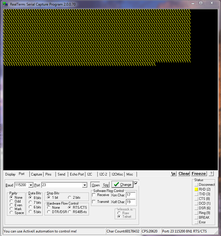

2019-01-23 2:21 PM
You are correct, I am connected to my computer over USB. I had already enabled asynchronous, I don't have RX USART enabled because I only need to send data out over the USART, I don't need to receive anything. Hardware flow control is disabled and "HAL_UART_Transmit(&huart2, data, 2, 10);" is in a while loop but I'm still getting the null character message. I might try to start fresh and see if I can get your example to work and then going to to those code to see where the problem is. I'm all ears if you have any suggestions :) Thanks again for your help!
