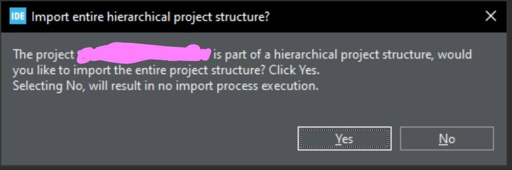

I have an issue here with the IDE. i have few projects compressed in .rar that I am using since the start of the year and everything worked well until this week. When i try to import one of these projects (any project) to my IDE, it shows me this window:
And it always showed something like "Import Successfully"...

Hi Imen.D.
I am openning the project by double clicking on the .cproject file and then, the window i add before appears. It has no option to show any issue... I can't import this project basically.
