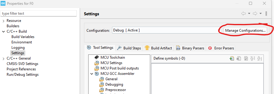

No option. Hardcoded behavior if debug type build configuration.

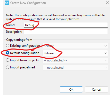

As workaround possibly remove original Debug configuration and create a new one based on Release type
Takes care starting from Release type, compiler optimizations are not debug compliant so you will have to set them to proper values

2023-01-20 8:48 AM
Thanks a lot!! I was going crazy... hahah
