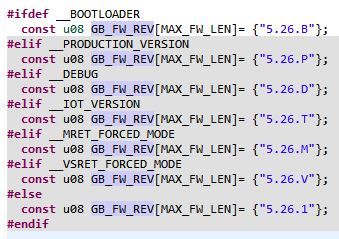

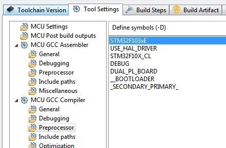

I have a __BOOTLOADER symbol defined for my project as shown in the attached image
I want to display firmware version based on the defined symbol so I have an #ifdef statement to select the correct string. The IDE displays the source code correctly: the greyed/ungreyed sections are displayed as expected.
But when I run the program, GB_FW_REV[] = "5.26.1" instead of "5.26.B".
What am I doing wrong?
Thanks!

It's as if, at the time this file is compiled, none of those symbols are known yet, so it defaults to the last line.
But I forgot to mention, I did do a sanity check by commenting all the other #elifs and just leaving
#ifdef __BOOTLOADER
const u08 GB_FW_REV[MAX_FW_LEN] = {"5.26.B"};
#endif
When i do that, GB_FW_REV[] = "5.26.B" as expected!

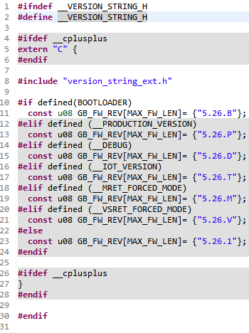

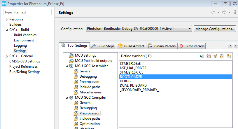

@Cartu38 OpenDev : I did not know that "__" (2 underscores) plus an upper case char is something reserved by the compiler (I'm not clear on that rule), but to make sure it's not causing a problem, I replaced "__BOOTLOADER" to "BOOTLOADER" throughout the code with no effect.
Also, "#elseif" does not seem to be supported...?
@ONadr.1 : I tried changing the format from #ifdef <SYMBOL1> #elif <SYMBOL2>... to #if defined(<SYMBOL1>) #elif defined (<SYMBOL2>) ... with no effect
@TDK : I could not find a flag that will force the compiler or linker to generate a list of #define symbols. Do you happen to know how?
So with my current settings and code, (changes made based on all advice received) the result at runtime is still GB_FW_REV[] = "5.26.1" even though it should clearly not be.
If I remove the preprocessor symbol "BOOTLOADER" from the settings and instead add" #define BOOTLOADER" in my code, then the result is GB_FW_REV[] = "5.26.B" as expected.
2021-07-19 9:01 AM
Solved!
Stupid mistake: the build configuration that I had selected as the active build configuration was not the same build configuration that I was debugging.
@Cartu38 OpenDev , @TDK, @ONadr.1 , thanks again for responding.
