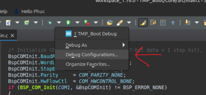

First, go into the IDE with a basic project that has proven to be able to program the board and debug. Then look into the Debug Configuration settings, which is in the dropdown menu of the debug button.

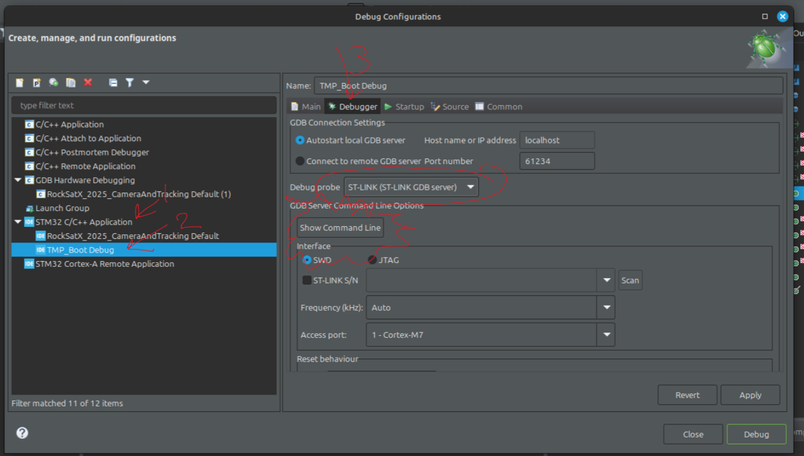

Then find the project and look in the Debugger tab, in here is where CubeIDE configures the connection of the debugger. One of the things you can do in this tab is Show Command Line, which tells you "exactly" what CubeIDE is doing.
Now I put "exactly" in quotes because the command for calling ST-LINK_gdbserver worked only partially. The program recognized the ST-LINK and the target device, but no complete connection was established; a busy wait happens indefinitely. So CubeIDE is still doing something additional that I don't know about.
