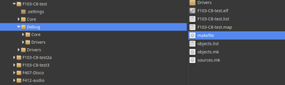

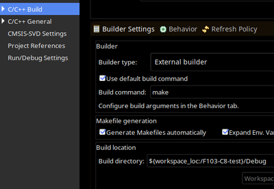

2024-01-23 8:55 AM
I found this :
and setting in project :
seems not lying here:
