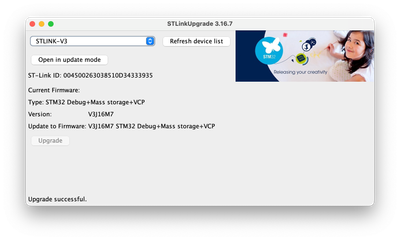

This is the upgrade window upon completion of my ST-Link firmware upgrade.
The ST-link now works a it used to work prior to the STM32CubeIDE update. Thanks so much!
