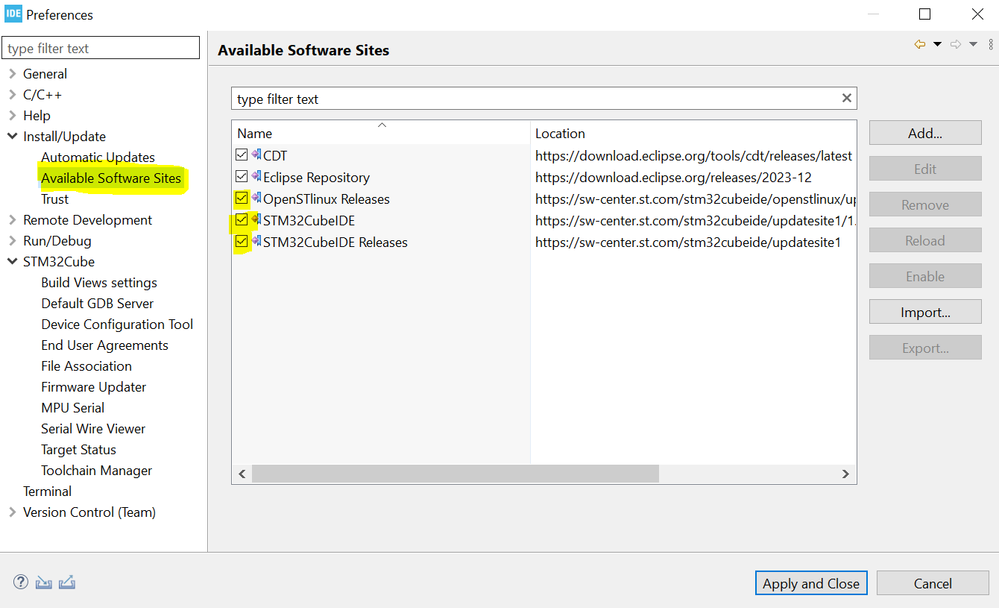

2024-04-04 6:04 AM
Hello @Marco77
Sorry for my late reply,
Please try to reload the available software site in Preferences>Install/Update> as demonstrated in attached screenshot, also don't forget to check the connexion.
