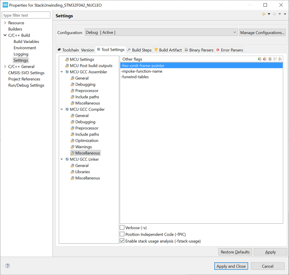

2020-10-07 1:53 AM
Ohh, I only ment that there is some dereferencing needed within the loop, sorry.
Copy backtrace.c and backtrace.h files from https://github.com/red-rocket-computing/backtrace to your project and start with their ping-pong like sample.
> Could you please tell me how to enable the compiler option you mentioned?
In STM32CubeIDE: Project > Properties > C/C++ build > Setings > Tool settings
these need to be enabled:
