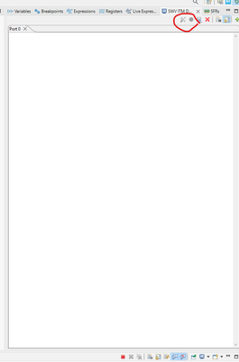

Does anybody have an idea why the settings button is grayed out?
MCU: STM32F412

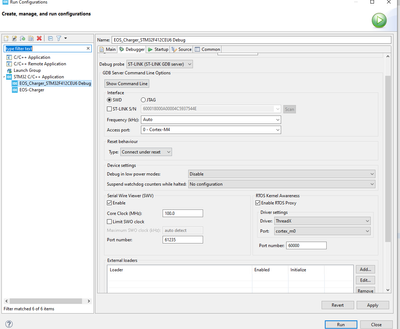

Other settings seem fine to me:
2023-08-17 5:06 AM
you are in active debug session ?
SWV settings only active then.
2023-08-17 5:56 AM
Yes, I press debug and the debug perspective opens.

printf unfortunately does not work with FREERTOS. As well as many other ST HAL functions. If anyone has an idea to make it work, let me know.
2023-08-18 7:14 AM - edited 2023-08-20 9:23 AM
Hello @tarmogr ,
Which CubeIDE version is used?
Try to increase the stack size/trace buffer size (window > Preferences > STM32Cube >Serial Wire Viewer).
