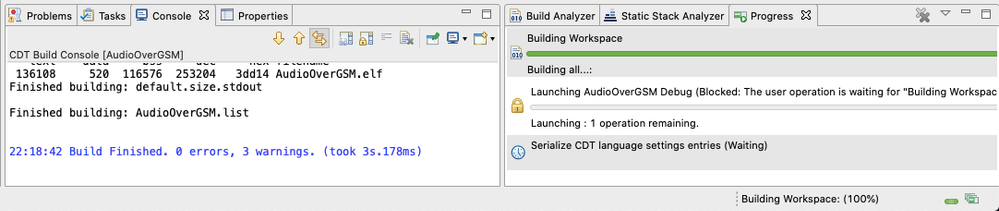

When i try to build a previously working project, the build process just sort of hangs. If it does complete, it won't let me debug.
The error code for debug is related to ST link server. I have ensured that ST Link server is properly installed.
The issue first appeared when i upgraded to 1.4.2. But after seeing this issue, i removed the app and installed 1.4.0, but the issue remains.
Steps tried (and didn't work):
Switch workspaces. Migrate projects. Restart OS. Clean and Build project.
2020-09-17 11:59 PM
[Update]
I was able to build the project after upgrading from 1.4.0 to 1.4.2.
Then i gave my laptop a sleep cycle (Closed lid - opened after a while) and it stopped building again. It won't even let me stop the build process. Just stuck at 'Building workspace 100%'. I have to force quit the application.
Another interesting observation is that after i re-launched the IDE and opened the project, the default status is 'Building workspace 100%'. and its just stuck.
[Update 2]
I had another folder in the IDE which had 3 imported projects. Removed them and restarted IDE. Build and Debug are worked once. After that stopped working again.
On another note: I cannot close the IDE normally. I have to open the activity monitor and force quit every time.

2020-09-18 9:43 AM
2020-09-18 9:49 AM
Let me recap.
I had STM32CubeIDE version 1.3.1 -> Upgraded to 1.4.2 -> Didn't work (Tried installing ST-Link server separately as well)
Uninstalled 1.4.2.
Installed 1.4.0 (installed ST-Link server as well) -> Didn't work -> Upgraded to 1.4.2 -> Build + debug worked once -> Now it builds (I can load the hex file and confirm the changes) but it gets stuck after first build so I can't check if I can debug.
