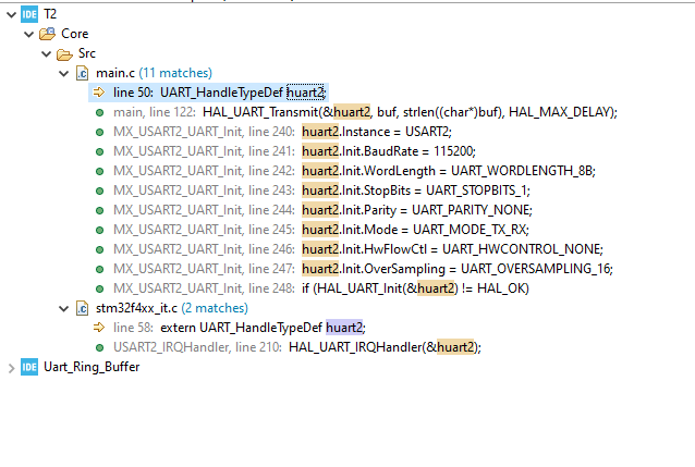

2022-03-30 6:27 AM - edited 2023-11-20 8:53 AM
After searching huart2 in my code as shown below , I use extern as you mention
Do you see any error (multiple definition of `huart2';) ?
2022-03-30 6:39 AM
Is it in an include file?

2022-03-30 8:31 AM
Thanks , Tesla & TDK
you are correct it was in UartRingBuffer.c
