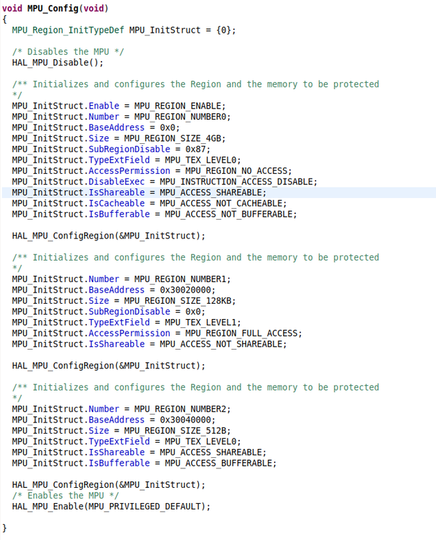

Assistance Needed: Troubleshooting Ethernet Communication Issue between Ubuntu 20.04 and Nucleo-H743ZI2
Dear Community Members,
I am seeking assistance in troubleshooting an Ethernet communication issue between my laptop running Ubuntu 20.04 and the Nucleo-H743ZI2 board. As per the setup, the laptop functions as the client while the Nucleo board acts as the server.

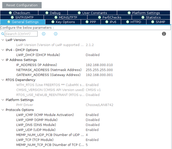

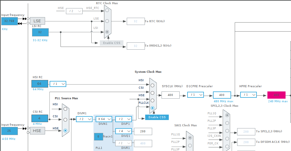

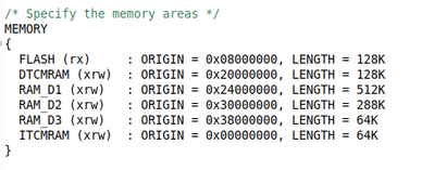

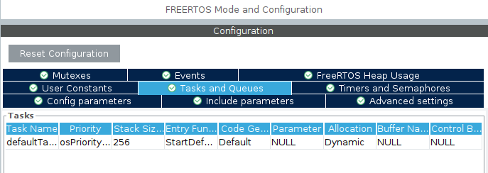

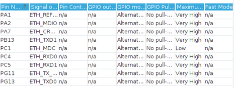

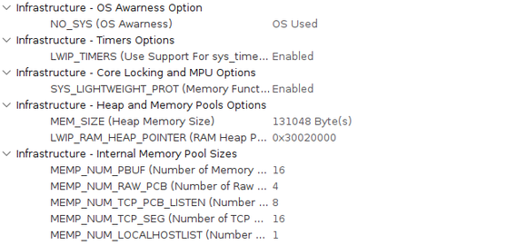

Despite diligently following the guide provided : https://community.st.com/t5/stm32-mcus/how-to-create-project-for-stm32h7-with-ethernet-and-lwip-stack/ta-p/49308 , I have encountered difficulties in successfully completing a ping test between the devices. I have attached relevant configurations for your reference.
@Adam BERLINGER I would greatly appreciate any insights or suggestions to resolve this issue promptly?
