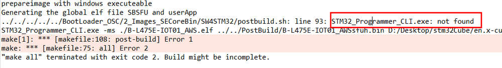

I found the solution to solved it, click the Window->preferences->STM32Cube->Toolchain Manager. My default toolchain is 10.3-2021.10, it build the project will make error, so, I install the 7-2018 or 9-2020. And set it as default, it can solved the issue, but I show a new error when compile the following:
Are there ways to solve it ?

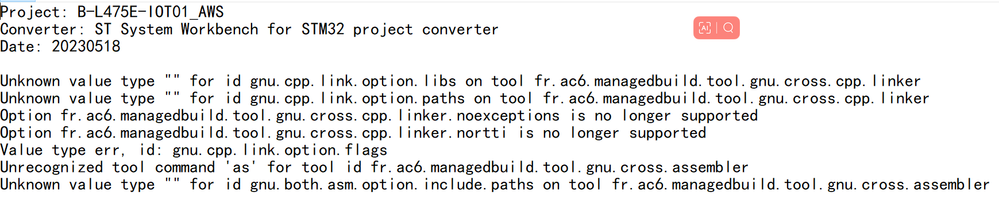

I have tried this, but it still show the same error. And here is some requires in " B-L475E-IOT01_AWS_converter.log ":
does it matter ?
2023-05-18 7:51 AM
hello, @KDJEM.1
I totaly sovled all issue, about the STM32_Programmer_CLT, I just need to install an app(Programm software) from st into the path as postbuild.sh it writes(just as default path when it is installing). Then it will build successfully. Thanks a lot for your responses:smiling_face_with_smiling_eyes:
