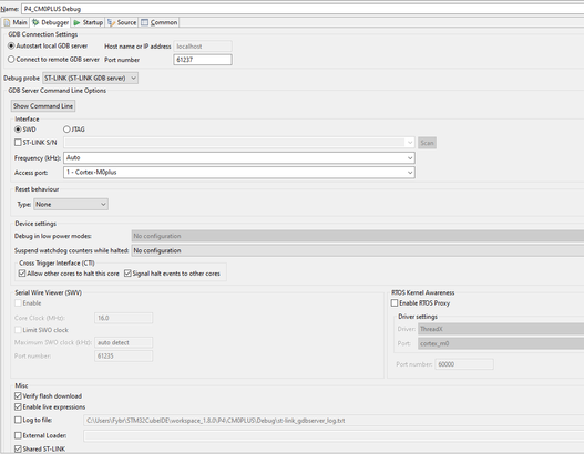

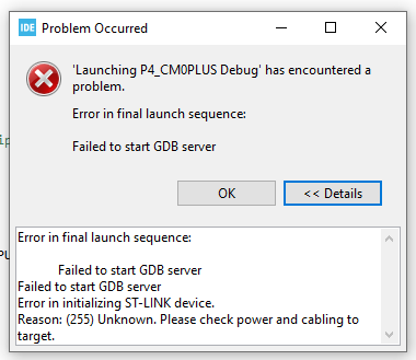

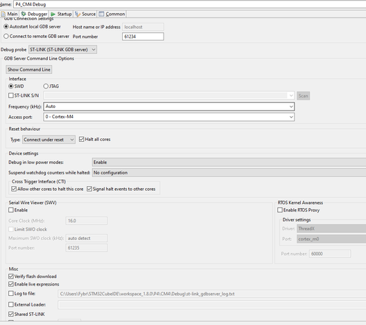

I am trying to debug both cores in STM32WL55CC chip. When trying debugging CM0+ i get error. I am using STM32CubeIDE ver 1.14.1 and also tried STM32CubeIDE ver 1.8 per a suggestion in older post, both don't work.
The followings are the configurations and error I am getting.
M4 running under debug:
and now starting M0 under debug:
M4 code is indeed running but debugger seems preoccupied with it and won’t share the resource for M0 debugging.
