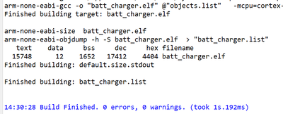

I am trying to switch a project from one MCU to the another. I made a new IOC file in MX and then replaced the existing IOC file in my IDE project with my fresh file. The overall configuration is identical except for the pinout, and I use a mix of HAL and LL libraries. The Drivers folder is giving me a boat-load of errors, but all of my user code seems to be fine.
I have tried cleaning/rebuilding the project, starting fresh with just the new IOC file, deleting the Drivers folder, saving and regenerating code, and more. The errors won't go away. I have attached the output.
What can I do to fix this? Are there any common mistakes or recommended fixes for this situation?

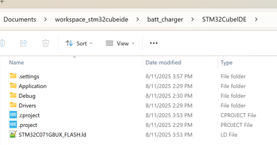

kzsd
Associate II
I switched to "Copy only the necessary library files" in the IOC file, which helped. But I think my remaining issues are because the .cproject file doesn't reflect the new MCU. What's the best way to change this?
Delete everything except the IOC and let it regenerate new metafiles. Back up files first. Once that works, copy over source files that you modified.
kzsd
Associate II
This process does not generate a new .project or .cproject file.
Does for me. Are you looking in the right directory (STM32CubeIDE)?
kzsd
Associate II
No, I do not see that directory appear after following your steps. It creates folders for Core, Drivers, and EWAM. The top level also has a here is a .mxproject file. Inside EWARM, there is a "project.eww" file but it is not complete at all.
