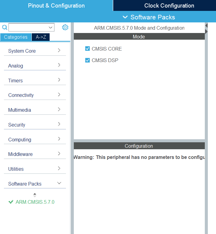

Step1: I activated it:

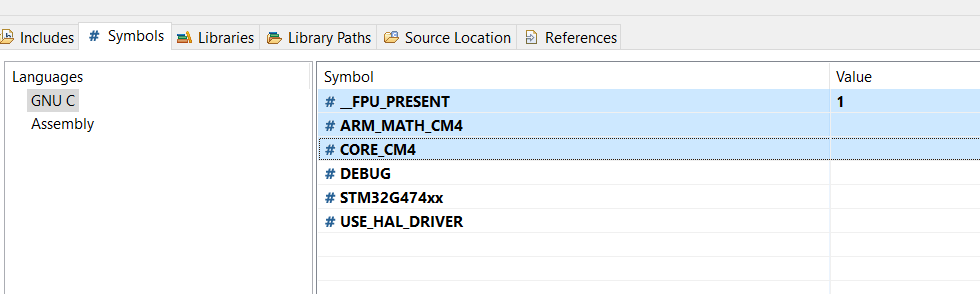

Step2: I set the Symbols:
__FPU_Present=1
ARM_MATH_CM4
CORE_CM4

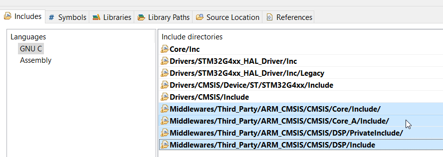

Step3: Checking the Includes:
Here it starts getting interesting, I do not know why the CubeIDE added Core_A? Is that correct.

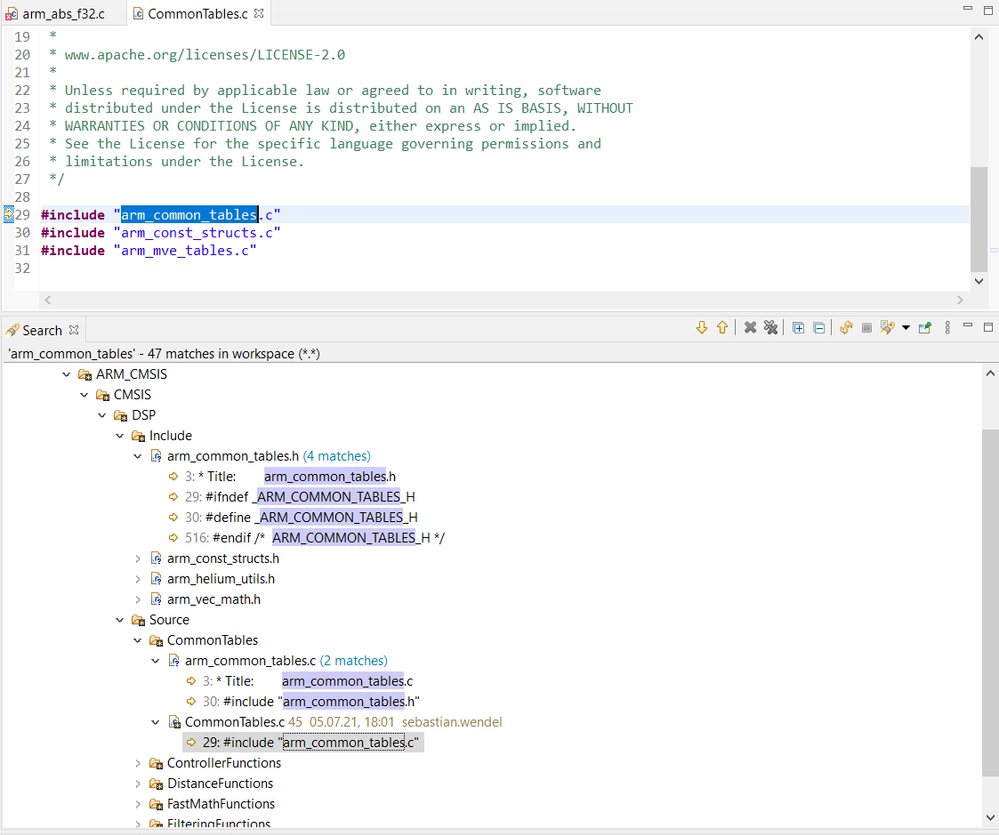

Step5: I include “arm_math.h�? in main.c and try to compile the project:
Here is the issue, I get ton’s of error-messages like this one:
c:\st\stm32cubeide_1.6.1\stm32cubeide\plugins\com.st.stm32cube.ide.mcu.externaltools.gnu-tools-for-stm32.9-2020-q2-update.win32_1.5.0.202011040924\tools\arm-none-eabi\bin\ld.exe: Middlewares/Third_Party/ARM_CMSIS/CMSIS/DSP/Source/CommonTables/arm_common_tables.o:(.rodata.twiddleCoef_4096_q15+0x0): multiple definition of `twiddleCoef_4096_q15'; Middlewares/Third_Party/ARM_CMSIS/CMSIS/DSP/Source/CommonTables/CommonTables.o:(.rodata.twiddleCoef_4096_q15+0x0): first defined here
What am I doing wrong, did I miss a flag, or add files that should not have been added?

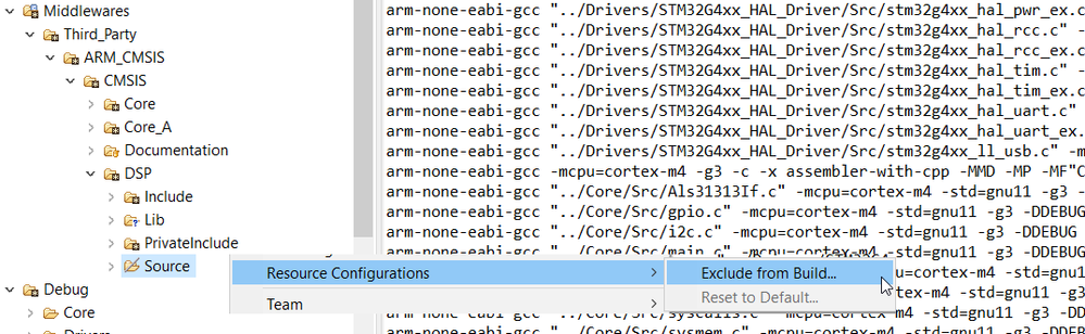

the issue was trivial to fix, all that was required was to exclude the folder from the build, but I did not notice it needed to be excluded. Thanks a lot for the support :thumbs_up: to everybody involved :
