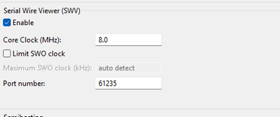

I read somewhere that the TPIU clock should be set to 8MHz. Then the same frequency must be entered in the Debugger setting page:

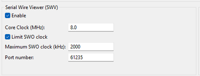

This did not work at first. I then played with the "Limit SWO clock" option in the debugger and limited the SWO clock to 2MHz.

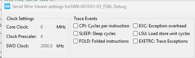

Now, when I enter the debugger, I see that it detected the correct clock settings with the correct pre-scaler:
and now the serial wire viewer works properly in CubeIDE...
