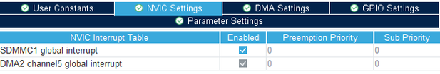

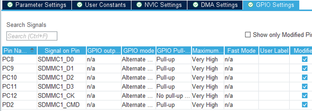

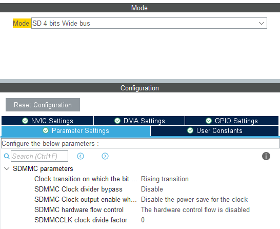

I am trying to perform SD Card file operations using STM32 HAL in STM32L451RCT6. I have been successful in mounting the SD Card, but read and write operations are not working. Here are the details of my IOC Configuration:

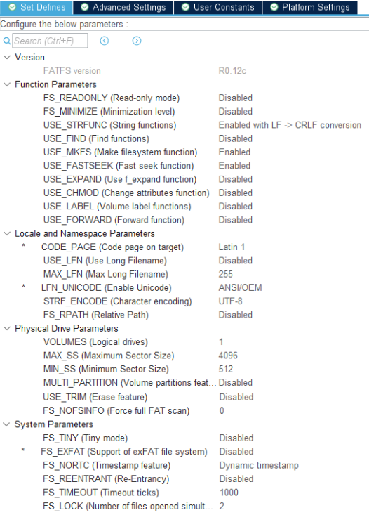

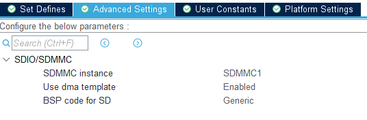

1. FatFS Configuration
2. SDMMC Configuration

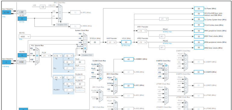

3. Clock configuration (Note: Since I am using UART and I2C as well, their clocks are also configured.

I have made some progress in this, I took some suggestions and since I was using a single DMA channel for SDMMC Tx and Rx, I was supposed to switch directions between Memory_to_Peripheral and Peripheral_to_Memory. After this, the f_open(), f_close() and f_read() functions return FR_OK, which means they are working. However:

I also had trouble with this and just got it working on an L4 chip, using this info. Read and write are ok and a bit faster now as well. I used Linux to verify the updates, but as a suggestion, you may want to try enabling hardware flow control on the SDMMC module. That allowed the SDIO clock to go from 3 to 48MHz for me. Also, try enabling USE_LFN under FatFS, with dynamic buffer on Heap. On that note, make sure you increase the heap/stack to something like 0x400/0x800 respectively, as in this ST video tutorial.
2023-12-03 10:48 PM - edited 2023-12-03 10:48 PM
Enable "USE_LFN ( Long File Name ) in FatFS Configuration>> Set Defines

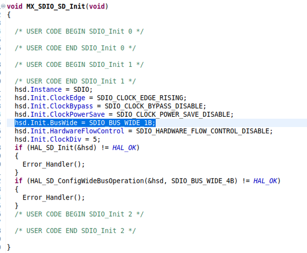

then secondly in SDMMC Configuration you just need to use 1 bit configuration as most of the SD cards above 8 GB will only work in 1 bit configuration
or you can can code as
by doing this your problem will be resolved
also you can enable FS_EXFAT to use linux partition SD cards
