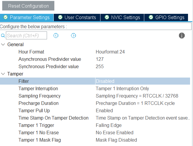

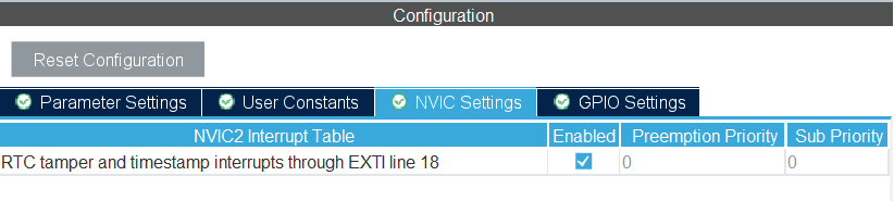

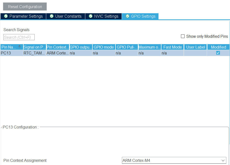

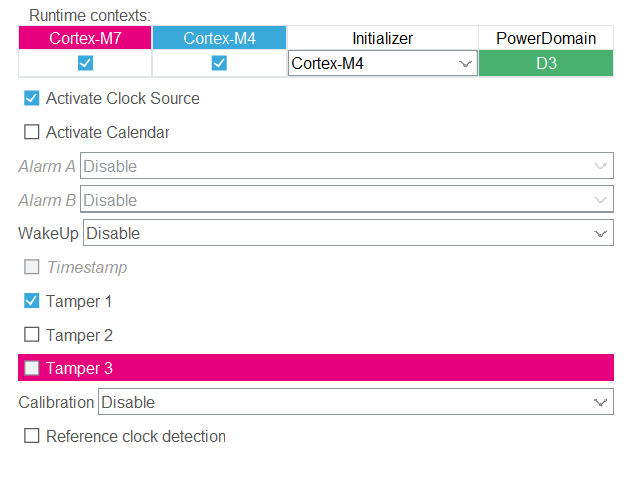

I configured the RTC tamper 1 interrupt as following. (As i did in M7, I only change the initilizer to Cortex-M4)
This is the same configuration that I use in M7 core and works perfectly. The code that is autogenerated is the same in the M4 core than in the M7 core.

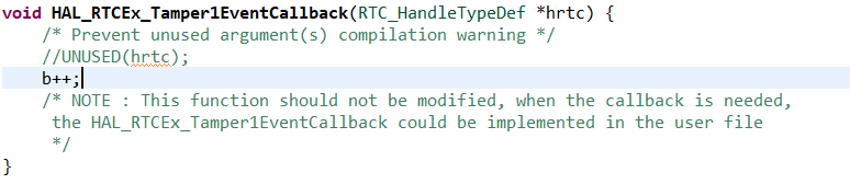

I add the following code as I did in M7 core.
But, the program never enters in the function because the TAMPER_1 is not working in M4 core.

Hello @CVael.1,
Can you specify the version of CubeMX you are using. Actually, I can find that tamper 1 and tamper 3 should not support it in CubeMX6.7.0
