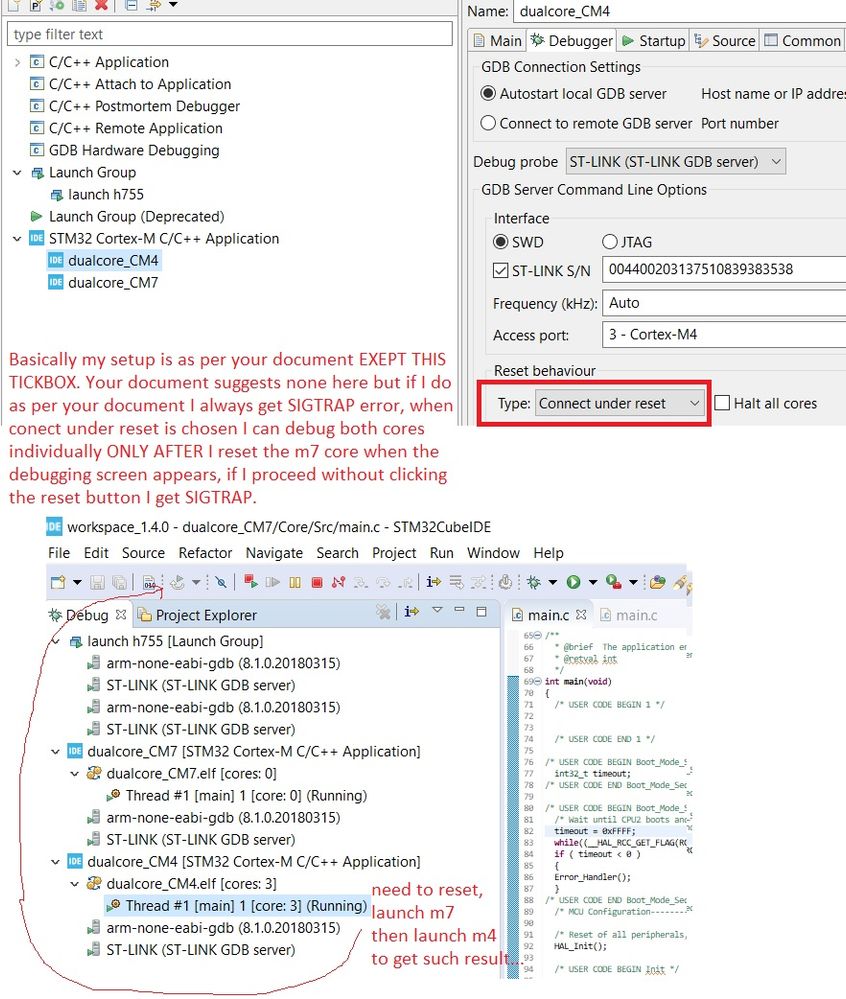

What is ST's response to this document and the fact that I am witnessing such behaviour (see image) ?? Was there simply an error in this document? I was following the doc only to be frustrated by M4 hitting a brick wall with SIGTRAP, there is mention of "option bytes" by user TDK here. Is thee something that I am missing and I can edit these option bytes in either STM32cubeIDE or CUBEMX or is this strictly a CubeProgrammer ability? BOOT_CM4=0 in the option bytes??? Where is this?? Can I change this Via GUI interface?? Should I proceed and think nothing of it and consider this error in document?
Please clarify... Thank you.

I'm not from ST but what is the problem with debugging? Are you not able to debug one core?
I don't understand what's with the document.
2020-11-10 4:54 AM
In the document, "none" for reset method should be chosen for debugging the CM_4. CM_7 should have "connect under reset". I chose "connect under reset" for both.
The CM_7 will release the CM_4 in software. But I dont notice this.

Are you trying to debug both cores at the same time?
2020-11-10 7:44 AM
Not really, I was just trying to understand the exact mechanism at play according to ST's documentation.
I have seen not much video proof of a working workflow.

Yes I can debug... But can you make your documentation not error prone next time? Or do I not understand you?
