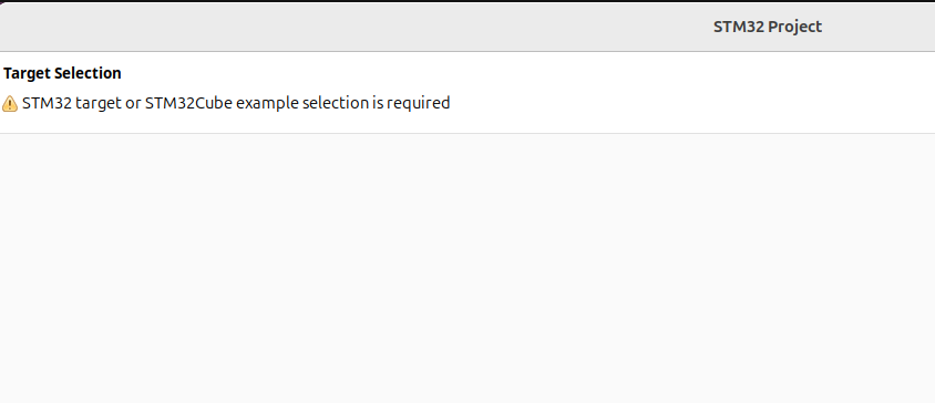

I need help!
After the installation, I am trying to start a new project in the STM32CudeIDE, it requires a target no more opinions
How can I resolve this?

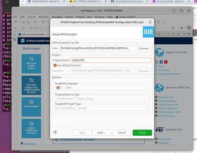

I found a possible solution
1- create the project in the STM32cudeMX
Select the language and target broad, save the project
2- Open the STM32cudeIDE
Search for the project that you created in the STM32cudeMX and be happy :)
cudeIDE prtscr

2024-10-28 1:26 AM
Is that what I am doing ( File>New>STM32 Project), but the second screen with the list of target select is not snowing up.
I am using ubuntu 24.04

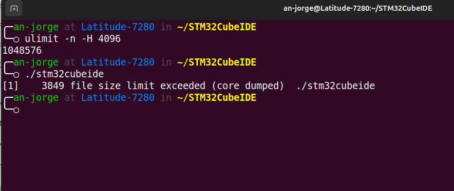

2024-10-28 9:13 AM - edited 2024-10-28 9:14 AM
Perhaps try
ulimit -n -H 4096
before starting CubeIDE.
The Eclipse bug seems to show itself in many different forms.
Running Ubuntu 24.10 myself and its fine.

2024-10-29 10:36 PM
1. Open a command prompt in the folder where CubeIDE executable is located
2. Enter
ulimit -n -H 4096 <enter>
3. enter
./stm32cubeide <enter>
Do this every time you want to use CubeIDE
2024-10-30 1:46 AM
Doesn't work
It still jumping the select target screen as in the video.
https://drive.google.com/file/d/1Xh2KV1O5ukZZbHWqwPttRqMuMFU8aegH/view?usp=sharing
prompt prtscr
