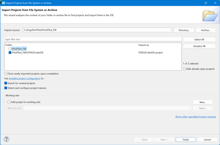

Recently STMCubeIDE started screwing up project imports created by CubeMX 6.14.1.
The project is created OK by CubeMX but when I open STM32CubeIDE it does the following:
Step 1
Step 2
Step 3
Step 4
I have reinstalled both CubeMX and the IDE, but that hasn't fixed it.
I have no clue on what to do.
I am running both these Cube apps on my laptop and they work fine.
Please help!

2025-06-08 12:23 AM - edited 2025-06-08 2:12 AM
you want import > project imports created by CubeMX , for stm32CubeIDE ,
but message shows:
...so you didnt generate for CubeIDE - why ?
see project settings in CubeMX :
...and set stm32CubeIDE .
2025-06-08 6:32 AM
Typically this happens if you have an IOC file where it shouldn't be. Look in all of the parent directories and ensure no IOC files or .project files are present.
2025-06-10 5:45 PM
Thanks for that TDK I will have a look. But it's odd exactly the same project, works on my laptop.
