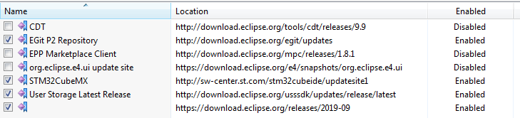

I get the following error during update in eclipse.
An error occurred while collecting items to be installed
session context was:(profile=STM32CubeIDE, phase=org.eclipse.equinox.internal.p2.engine.phases.Collect, operand=, action=).
No repository found containing: osgi.bundle,org.eclipse.epp.mpc.core,1.8.1.v20191107-0507
No repository found containing: osgi.bundle,org.eclipse.epp.mpc.core.win32,1.8.1.v20191106-1317
No repository found containing: osgi.bundle,org.eclipse.epp.mpc.help.ui,1.8.1.v20191106-1317
No repository found containing: osgi.bundle,org.eclipse.epp.mpc.ui,1.8.1.v20191119-1757
No repository found containing: osgi.bundle,org.eclipse.epp.mpc.ui.css,1.8.1.v20191106-1317
No repository found containing: org.eclipse.update.feature,org.eclipse.epp.mpc,1.8.1.v20191119-1757

Hi BelSoft,
That's probably due to a well known bug in Eclipse, existing for a while.
Could you check if the MPC EPP Marketplace Client update-site URL exists in Window > Preferences > Install/Update > Available Software Sites?
If so then uncheck or remove it and try again.

Hi Julien
I found that bug info as well and tried it. But it didn't resolve my issue. :(
I have http://sw-center.st.com/stm32cubeide/updatesite1/ URL as STM32CubeMX Site. I also tried to change from http to https.
No luck so far.

I'm not aware that I updated Eclipse. I did install a Git Plugin. After I unticked EPP Marketplace Client, CDT and org.eclipse.e4.ui.. I could update STM32CubeIDE.
2020-01-16 2:02 AM
Good news !
Yes maybe my suggestion to uncheck "MPC" wasn't clear enough, mpc wording is only a small part of the URL, should have wrote "EPP Marketplace Client".
Will Edit the answer for others.
