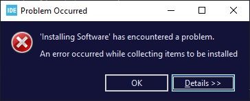

I'm trying to update my STM32CubeIDE 1.6.1 to the newest version but I get the following error:
More details are here: https://pastebin.com/NpDgAkMQ
Does anyone know the solution to this besides reinstalling everything?

Found the fix - I deleted the STM32CubeIDE Releases link, restarted Cube, then addded https://sw-center.st.com/stm32cubeide/updatesite1/ and update finally worked.

@Imen DAHMEN I tried both solutions mentioned there; deleting the cache folder inside STM32CubeIDE\p2\org.eclipse.equinox.p2.repository
and appending the version number to the software site like this "https://sw-center.st.com/stm32cubeide/updatesite1/1.7.0"
and also tried "https://sw-center.st.com/stm32cubeide/updatesite1/1.7".
But none of this helped.
2021-09-30 3:25 AM
