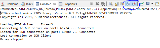

You can change this from the prefernces page in your link above, or toggle this on/off with these buttons directly in console:

This setting is one of the first settings I change when starting a new workspace in CubeIDE.
