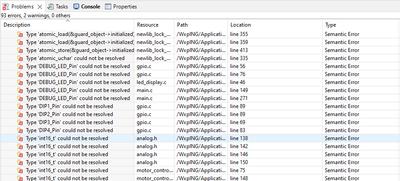

Here is a snapshot of my errors.
As you can see, most of the errors shown in the standard libraries of the MCU like the data types; example uint16_t. Others with symbols not declared and cannot be found
