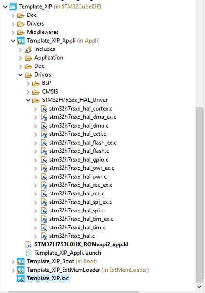

2025-07-30 5:40 PM - edited 2025-07-30 5:43 PM
Try importing the Template_XIP project into STM32CubeIDE first. Then open the IOC file to add the SPI peripheral, and generate code. It should add the HAL SPI drivers. That's how it is working for me.

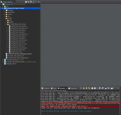

2025-07-31 2:11 AM
Hello @Karl Yamashita,
This is exactly what I tried, but for some reason, it doesn’t work—neither on my Mac nor on Windows. I’ve tried reinstalling STM32CubeIDE with no success. I also ran the IDE as administrator on both macOS and Windows, but that didn’t help either. Lastly, I gave it a try using STM32CubeMX, but still no luck.
Here’s a screenshot of my setup: I imported the Template_XIP project from the following path:
STM32Cube/Repository/STM32Cube_FW_H7RS_V1.2.0/Projects/NUCLEO-H7S3L8/Templates/Template_XIP
thanks :)
2025-08-01 5:26 PM
I tried it on windows and it works. i think it is a problem with macOS.
