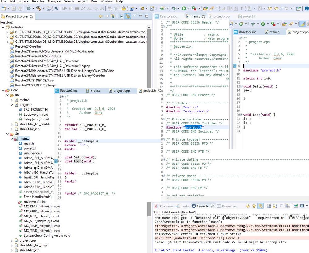

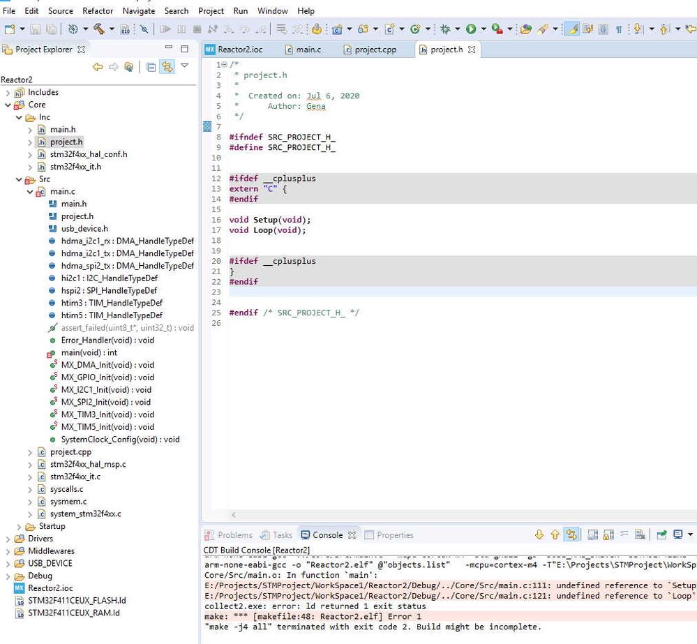

I see what ifdef __cplusplus extern "C" { #endif highlighted in gray , although I was creating a C ++ project. I think that the C ++ project is not created correctly, it is created as a C project. But how to fix it and why this happens I don't know....

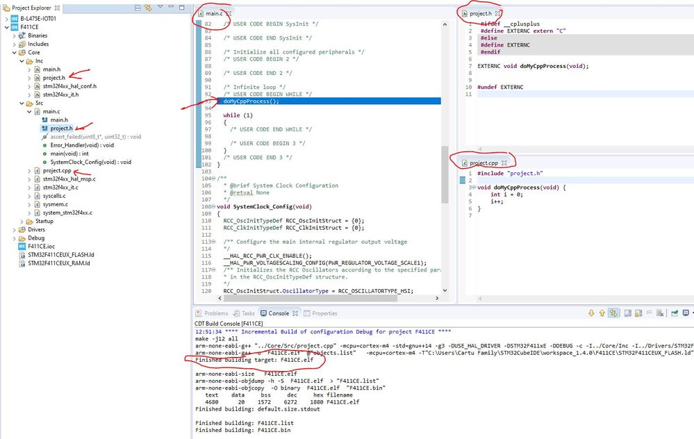

Sounds ok but most probably your issue is project.cpp not project.h
Works for me. Looks at snapshot below. I've added my x2 files (project.h & project.cpp) plus project.h include within main.c. Obviously I'm using project.h prototypes within main.c.
Compile sucess. G++ is well invoked as expected.

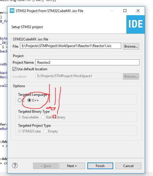

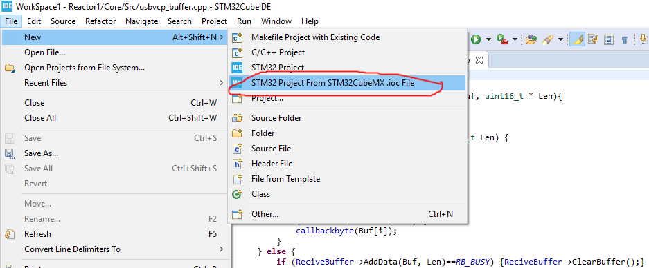

all ok in my project.cpp. If i create new STM32 project , the code work true. But if I create project from .ioc file th bug.

Is your project well set as C++ project ?. Many way to know.
1) All case select your project from project explorer view. Then mouse right click to get contextual menu
2) Either: you should be able to see a menu so called "Convert to ...". If convert to C++ means your project setting is C ....
3) Or: rely on properties to get build settings. Are C & C++ compiler options (includes for example) visible ?
If your project is not C++ sounds like a bug creating your project. Work around if required is obvious let's perform previous "Convert to C++"
2020-07-30 1:42 PM
Thank you! Problem solved. I took your advice and converted it to c ++ . After that, the project compiles without problems. Nevertheless, I am absolutely sure that I created a C ++ project. So it is an obvious bug CubeIDE. Despite the choice in the wizard C++ he creates a C project.
2020-07-30 2:02 PM
Good to get compile sucess. Just having a try from .ioc project creation and C++ selection is providing me a C++ project.

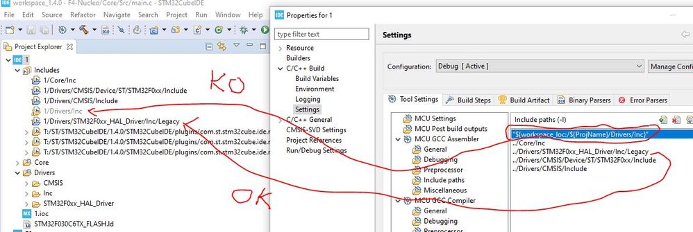

Hi I have encountered the exact same problem as you did. And I have solved the problem.
I found this can be solved by including it's .c implementation, such as:
#include <stm32746g_discovery_lcd.h>
#include <stm32746g_discovery_lcd.c>But this is not a correct way to solve it.
The correct way is: Besides adding the folder of the header file to Includes, you have to also add the folder of .c file to linker folder.
