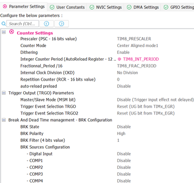

I am using STM32CubeIDE (v1.15.1) to develop firmware for an STM32G431 MCU and attempting to configure
TIM8 to use dithering. I have defined the following constants:
TIM8_KHZ = 20
TIM8_PRESCALER = (1-1) = 0
TIM8_PERIOD = (((16*170000/TIM8_KHZ)/2)/(TIM8_PRESCALER+1)) = 68000
TIM8_INT_PERIOD = (TIM8_PERIOD >> 4) = 4250
TIM8_FRAC_PERIOD = (TIM8_PERIOD & 0xF) = 0
The first sign of trouble is that the period/ARR parameter gets marked as invalid with a red X:

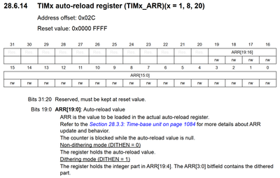

Evidently, the software believes that this register is supposed to be limited to 12 bits, but this is not correct, as shown by the reference manual RM0440:
If I proceed to generate code anyway, it produces
htim8.Init.Period = TIM8_INT_PERIOD; // somewhat misleading
__HAL_TIM_SET_AUTORELOAD(&htim8, 68000); // same as TIM8_PERIOD
Everything appears to work OK except that STM32CubeIDE shows that error/warning about the period being larger than 0x0FFF. Why does the configuration software limit this value to 12 bits? Shouldn't it still be 16?

1. In the CubeMX GUI "Fractional" is incorrectly spelled as "Fractionnal".
2. The CubeMX GUI misrepresents the way dithering mode works. It provides fields that when dithering is ON, the ARR register's bits are split into 12 bits of "Integer" and 4 bits of "fractional" components. In fact, the ARR register is expanded with extra bits to become 20 bits, only the semantics of the 4 lower bits are different (hence the dithering).
