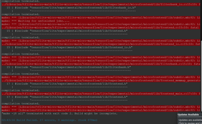

When I then also try to adding the Source Location:
I recieve even more errors. Where most of the errors are: "No such file or directory". See image:

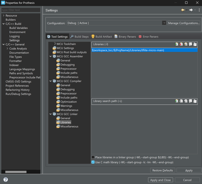

I have also trying the folder location in the C/C++ Build settings under MCU GCC Linker/Libraries, but with no success:
