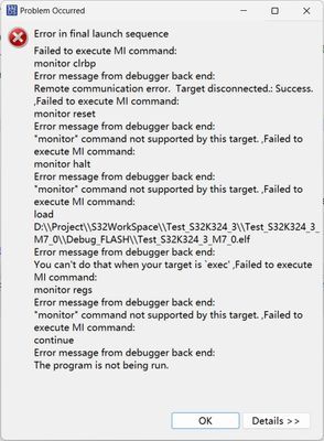

Hi Adrian
I encountered maybe the same problem with you.
My setup is
IDE: S32DS
Development board: S32K324
And i tried several methods as below
1. check the power
2. check the wheather the interface is plugged
3. restart my PC
4. close all breakpoints
And it still didn't work. It will be appreciated if you can help me analysize the log
