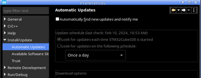

2024-02-25 1:44 AM
Try this : (no need to DISCONNECT FROM INTERNET )
menu -> preferences -> disable search and automatic updates ->
On my (Linux) system improved IDE behavior a lot.
2024-02-27 7:39 PM
Thank you for the suggestion but I've lost my IOC project =) Hopefully it's not my main project, otherwise I'll be crying by now.
But don't worry for my lost test project, I've learned the hardway that CubeIDE isn't reliable.
The thing is that, if keep my wifi on and I disable the automatic updates, then when I try to open the IOC file, Eclipse shows up 2 windows, one after another, as usual: Loading the IOC project and Rendering (Java eats 100% CPU). Then nothing happens: the IOC project never renders (Java CPU consumption drops to 0%; seems it enters into an infinite loop or so).
Then I need to kill the Java instance and when I try to reload the project, the IOC gets somehow corrupted so that CubeIDE never enters into the Eclipse IDE. Some users or ST employees have suggested to delete the project's folder =(
