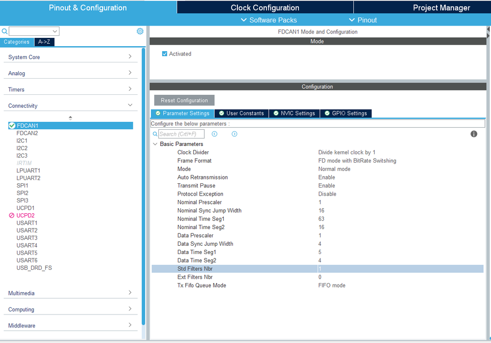

STM32CubeIDE 1.7.0 code on STM32G0B1 CAN bus ID filter not working once using (HAL_FDCAN_ConfigGlobalFilter(&hfdcan1, FDCAN_REJECT, FDCAN_REJECT, FDCAN_FILTER_REMOTE, FDCAN_FILTER_REMOTE) .
Jackle
Associate III
Classic CAN configuration as below. when the line "if(HAL_FDCAN_ConfigGlobalFilter(...))" is removed, the CAN messages are received without issue. The transmitted message is set as ID: 0x111 . Confirmed by a CAN bus monitor.
Configuration as below:
FDCAN_FilterTypeDef sFilterConfig;
sFilterConfig.IdType = FDCAN_STANDARD_ID;
sFilterConfig.FilterIndex = 0;
sFilterConfig.FilterType = FDCAN_FILTER_MASK;
sFilterConfig.FilterConfig = FDCAN_FILTER_TO_RXFIFO0;
sFilterConfig.FilterID1 = 0x111;
sFilterConfig.FilterID2 = 0x7FF;
  if(HAL_FDCAN_ConfigFilter(&hfdcan1, &sFilterConfig)!= HAL_OK)
Error_Handler();
// If comment this one, it works.
if(HAL_FDCAN_ConfigGlobalFilter(&hfdcan1, FDCAN_REJECT, FDCAN_REJECT, FDCAN_FILTER_REMOTE, FDCAN_FILTER_REMOTE) != HAL_OK)
Error_Handler();
if(HAL_FDCAN_Start(&hfdcan1) != HAL_OK)
Error_Handler();
1 ACCEPTED SOLUTION
Accepted Solutions
Jackle
Associate III
Mystery Solved! Need to change the default "Std Filters Nbr" setting from 0 to 1 or More.

Hi @Imen DAHMEN​ ,
This is exactly my point. The code seems no problem. But it's not working once I add
Error_Handler();
If I use FDCAN_ACCEPT_IN_RX_FIFO0 as parameter, I can receive the message.
But this is wrong. It means the message doesn't match with the ID.
Jackle
Jackle
Associate III
