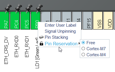

In your case it looks like MX_GPIO_Init does not init the LEDs at all (LD2 is on PE1 which is not clocked) but the other peripheral (AF) pins. This may be because you have not specified which core handles those pins. If you go to the System Core GPIO tab in CubeMX and make a Pin Context Assignment for PE1 to say ARM Cortex-M4, proper init code will be generated.

2020-08-09 4:55 AM
Thank you very much! You are awesome! That actually makes a lot of sense, and difference!
Right-clicking those pins shows an additional menu item "Pin Reservation" with choices "Free", "Cortex-M7", and "Cortex-M4".
I didn't click that sub-menu, as I saw the LED labels already. =)
Now I reserved LD1 for MC4, LD2 for MC7, and LD3 Free (uses by both cores).
