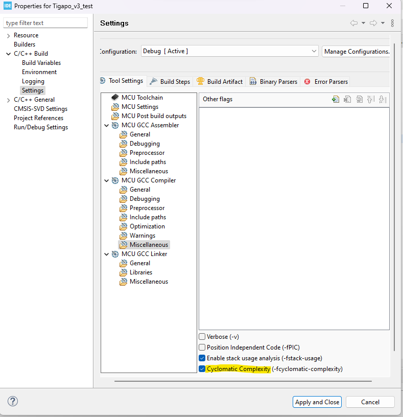

Good day to all,
in the new IDE version the compilation does not work at all.
Because the cyclomatic is always active. Even if I set it to 0 I get the following (kept extra short because it is always just about the parameter).
arm-none-eabi-gcc: error: unrecognized command-line option '-fcyclomatic-complexity'
arm-none-eabi-gcc "../SRV_FREERTOS/portable/STM32/lptimTick.c" -mcpu=cortex-m0plus -std=gnu11 -g3 -DDEBUG -DSTM32L0 -DSTM32L082xx -c -I../Core -I../Configs ...

2023-04-27 2:56 AM
Thank you, we searched through the option but didn't see it. My remaining concern here it that the IDE defaulted to enable an option that was not there one version ago, breaking the build process for non ST compilers in the process. (as far as I could figure out this is NOT a standard gcc option but something a plugin CAN add)
