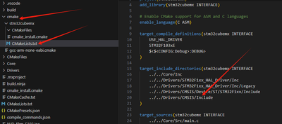

2024-10-11 7:19 PM
2024-10-14 12:40 AM
Hi All,
I managed to fix the issue.
As it turns out, STM32CubeIDE uses relative paths of the system for all the include folders and not absolute paths(Default behaviour of the IDE as far as I can tell). So, I had to manually configure the project to use relative paths.
After updating the project to use relative paths, its building on the server.
