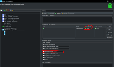

In Debug configurations, uncheck the "set breakpoint on main" box. This will let you launch it without having to "resume" when it hits the breakpoint at main, which may be causing the issue.
You can also set "Download: False" which will cause it not to update the flash before it runs the program. To debug in this mode, hit "Run" to upload the file, then hit "Debug" and it will attach to the process wherever it happens to be at. I don't think there is any upset in program flow, but there may be something minor.

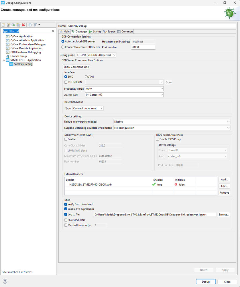

I have tried a bit here and there. Turning off "Download" as suggested by TDK didn´t do anything. But I looked into other projects that still debug correctly, and the external loader was not configured correctly. But it is still behaving weired.
"Run" still works perfectly fine, and programming it with the "STM32CubeProgrammer" also works fine, but when I try "Debug" it downloads everything, but when I hit the "Resume" button, it shows the startup screen of the last program that was loaded to it (with a few of missing pixels) as if the starting occures at a wrong memory spot. Now I can press the reset button, and the correct program starts.

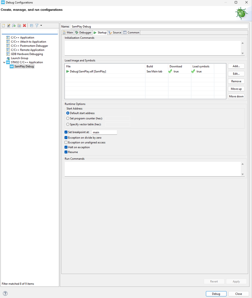

Here are my screenshots of the debug config:
I could not upload the .launch file because the file format is not supported, and the gdb server log is too big to be uploaded. So I put it into my onedrive cloud an I have generated the following link:
