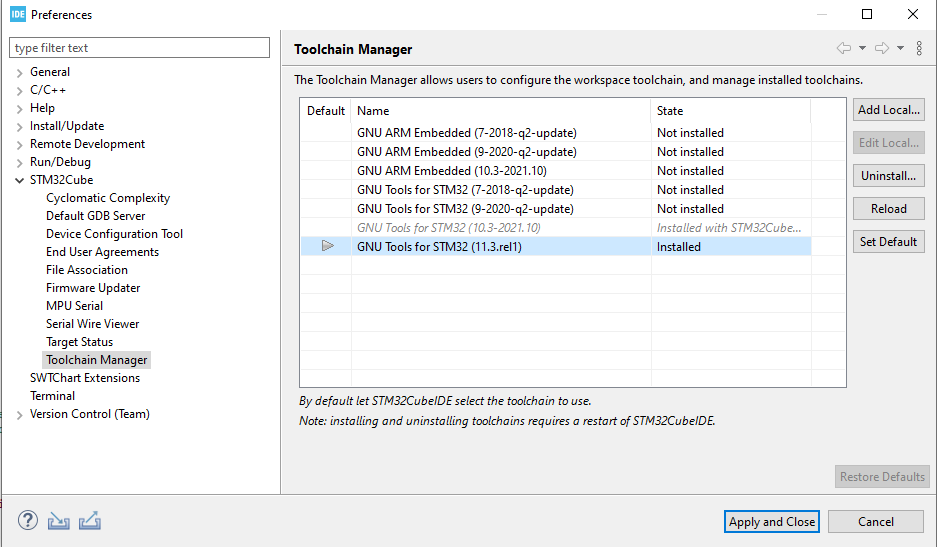

You can select any toolchain you want. See picture down below. Using the same version as your client is a good starting point.

I am having trouble with this issue still. The image is not showing up, for starters, so I'm not positive what is being shown. Specifically, I don't seem to be able to install older patches of given GNU Tools versions. I cannot rebuild software that has already been released because the GNU Tools version used for the build got auto-updated out and I cannot find a way to roll it back.
My build requires "C:\ST\STM32CubeIDE_1.3.0\STM32CubeIDE\plugins\com.st.stm32cube.ide.mcu.externaltools.gnu-tools-for-stm32.10.3-2021.10.win32_1.0.100.202210260954\tools\bin\arm-none-eabi-gcc".
I only have one revision of v10.3 available, and neither of the ones actually installed match the version mentioned above. Please advise on how to install the old version.
