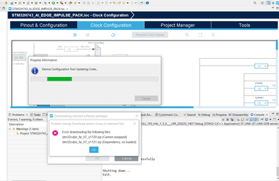

I cannot start a new project in the STM32 IDE. Tested in 2 diferent instalations (computers) and the same error ocurrs:
STM32CUBE_FW_H7_V1120 CANNOT UNZIPPED NO LOADED

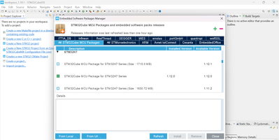

Hello @Amilton Rogério da Silva ,
I reproduced your request with STM32CubeIDE 1.18.1, and I was able to install the STM32H7 Firmware 1.12.0.
Thanks.
Mahmoud
2025-05-13 8:02 AM
We are unable to unzip the STM32H7 Firmware 1.12.0 out of some reasons, but we don't know why.
Exactly like this.
2025-05-20 7:40 PM
I was having this exact same issue and after some time of trying a few different things I found that the cause for me was there was not enough storage space in my C drive. To get this to work, I needed at least 6GB of space on my C drive, after I made that change it seemed to resolve the issue. The H7 series STM32 projects seem to require a larger amount of space than many of the other projects which may be why I hadn't encountered this issue before. I hope this helps.
