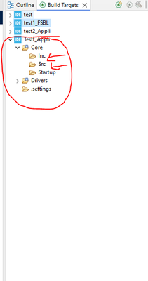

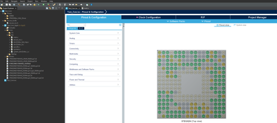

Hello @Mahmoud Ben Romdhane thank you for your quick response... I am using STMproducts from past three years. there is no problem with older version of cube ide . issue with new cube ide software. below is the proper procedure what i am trying to do.
i gave filename and selected appli option and then finish
It was asking these option i kept it as it is
Then selected PA5 as output
Then i clicked generate code
It created only inc and src folders , there is no related folders and files
